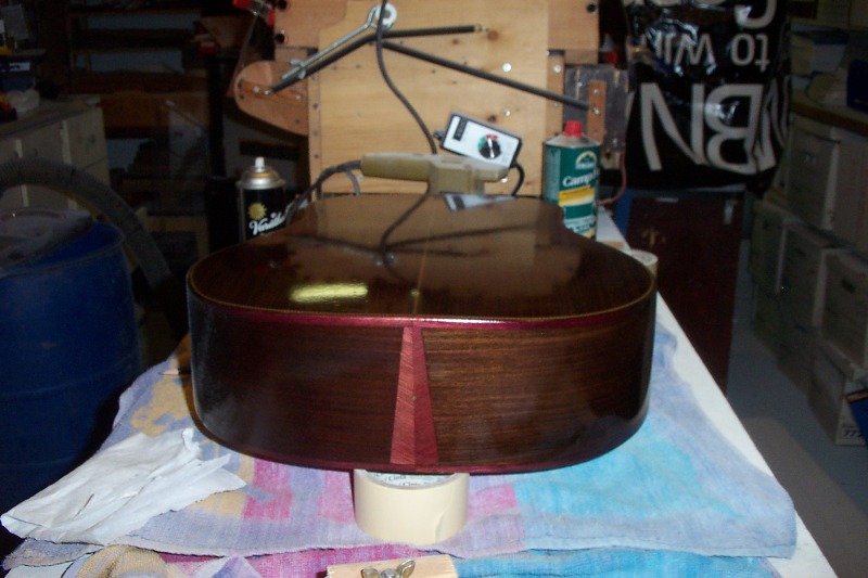

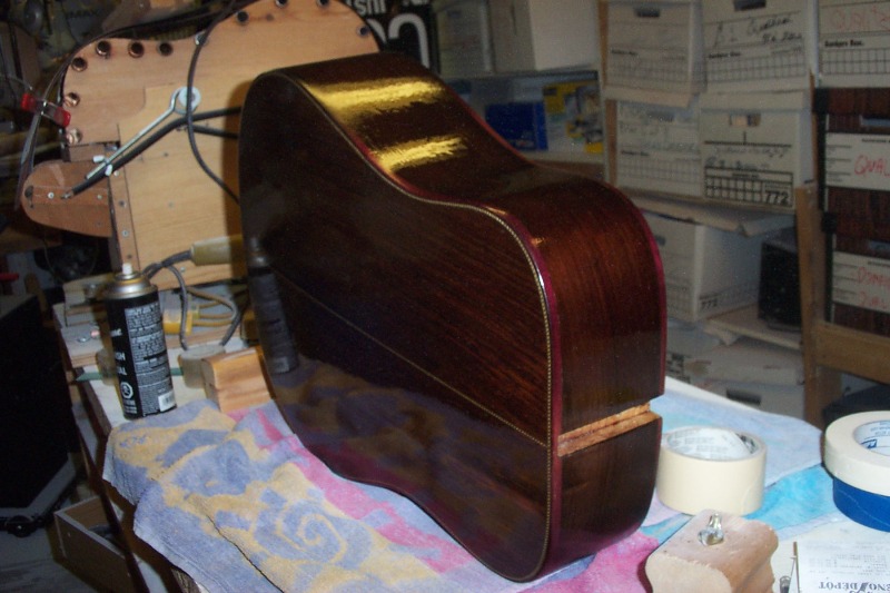

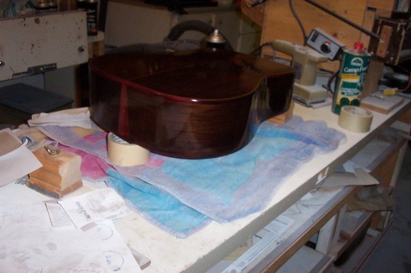

I decided to spray up to 12 coats so i'd have something to work with when i do the level-sanding, it shines even more today, i'll post some more pics tonight!
Thanks!
PostPosted: Fri Sep 29, 2006 11:25 am
Ok guys, here's how it looks with a few more coats on, i have now 12 coats on the back and on one side, it needs 3 coats on the other side and 3 more on the top.
The spraying should all be done by tomorrow night and will let it sit and cure for the next 2 weeks
Thanks for watching

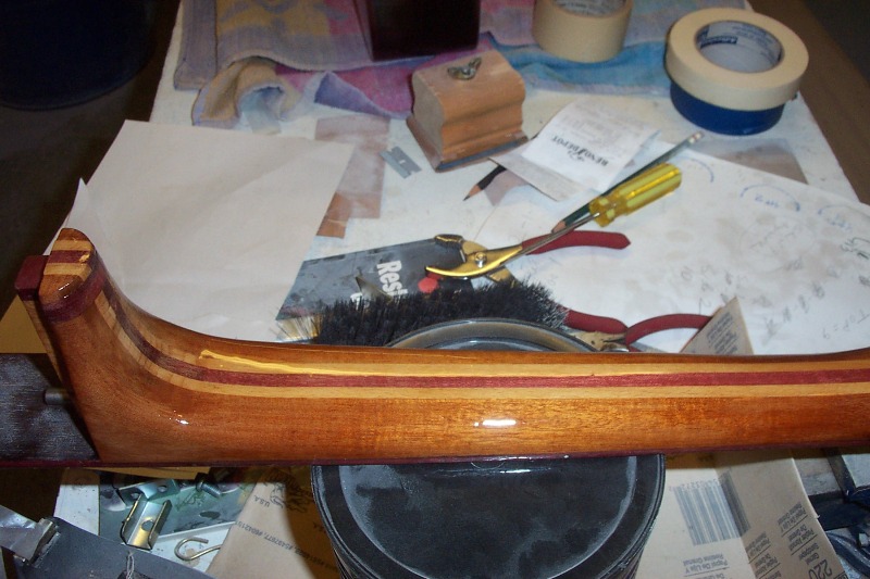

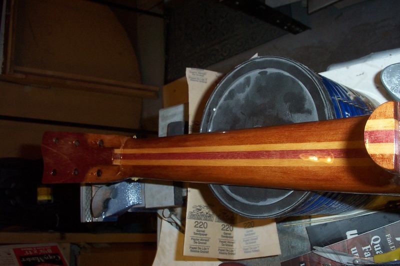

Finished spraying tonight, 15 coats on the top and 12-13 coats on the back and sides. Gonna let it dry for a couple of weeks now and sand level after.
That will give me a break from finishing and will be able to return to the mando building a bit!
Thanks for all the encouragement and great input guys, it really means a lot to me!
